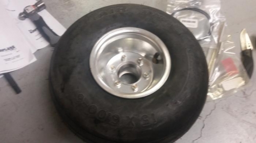

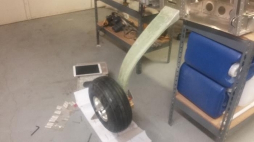

Brief Description:  3 - Installed left tire & wheel to main gear

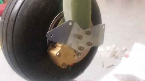

I put a little bit of air in the tube and inserted it into the tire, and then fit the outer wheel hub. Placing the rear wheel hub on the floor I pushed the assembly together and tightened the 3 nuts to the fixed bolts. I then installed the remaining 3 nuts & bolts. Using dish washing soap I greased the o-ring and tire rim and then forced the o-ring past the tire lip so that it snapped in place in the middle of the assembled hub. Finally, I greased the two tapered roller bearings, and installed the wheel and brake pad.
inner tube & o-ring inserted
tire & wheel installed to gear
