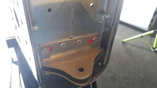

Brief Description:  1 - Removed vert stab & rudder for rework
While reviewing my work from last week I noticed a photo that showed two holes that need rivets, and also realized that I was missing 4 rivnuts on the vertical stabilizer along with one missing M3 clearance hole in the tail cone.
I removed the rudder and then measured, marked and drilled the missing hole. I then removed the vertical stabilizer, and installed the two missing rivets. There is a clearance hole on the backside sheet metal layer (1 of 3) that does not get riveted, which is probably why I left it out early on. I installed the two 5/32" rivets through the 2 layers.
missing rivets and rivnuts

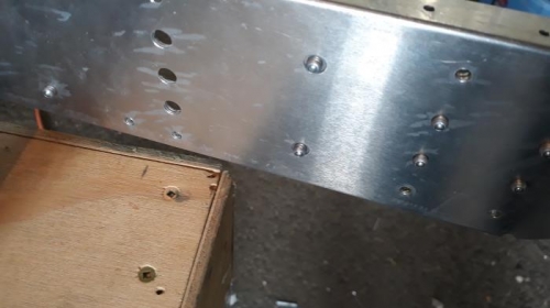

missing hole drilled
rivets installed
rivets installed
