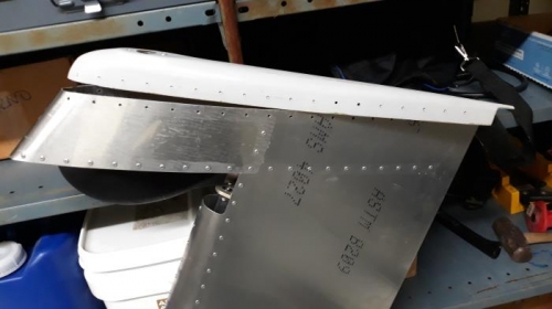

1 - Drilled new wire routing holes in rudder
The wire routing in the rudder was not clearly explained in the manual, but after looking at other builders sites, I found the correct way.
I removed the rivets and the fiberglass cap from the rudder and drilled new grommet holes for the wire routing.
removed rivets and rudder cap

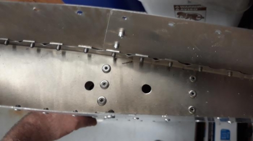

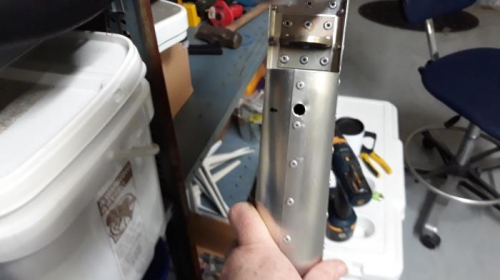

drilled wire exit hole
drilled new entrance hole
