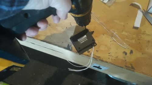

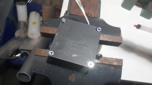

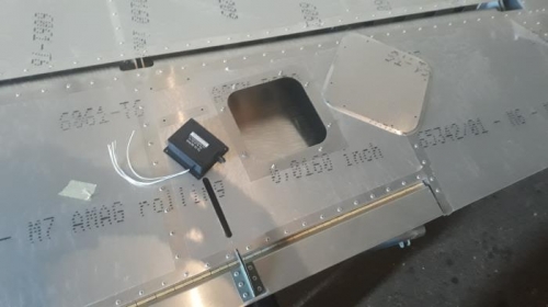

I drilled out the 4 mounting holes in the elevator trim servo, and then installed M3 rivnuts. These will allow the servo to be secured with screws from the outside of the sikin.
I need to order the linkage and connect & route the electrical wire to finish the installation.
