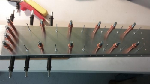

Prepared parts for assembly. The plastic film on one of the spars didn't release well at all and took quite a lot of time to remove. I had to use acetone to remove the residure afterwards.

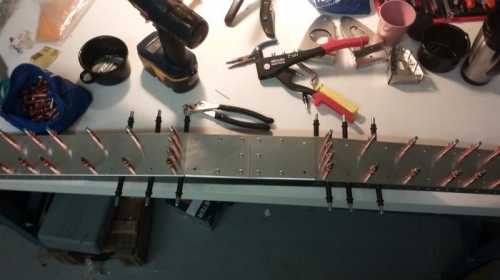

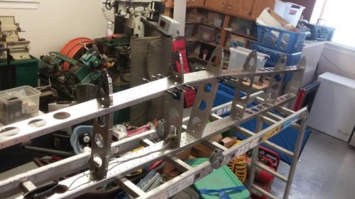

I assembled the front horiz stab spar and riveted it together, then assembled it to rest of the assembly and riveted it together. It went pretty fast and I think I'm getting better at aligning rivet holes the first time instead of adjusting later.
front spar assembly
front spar assembly
better way to align holes first
