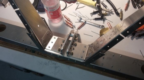

Brief Description:  Elevator spar riveting
FINISHED RIVETING THE THE CENTER SPAR SECTION TOGETHER. I ADDED 3 RIVETS THAT ARE CALLED FOR LATER IN THE BUILD FOR THE SKIN, SO I DRILLED THEM OUT. ONE OF THE HINGE BRACKETS IS DRILLED OUT OF HOLE LOCATION TOLERANCE. I'LL NEED TO DRILL OUT THE SPAR TO MATCH.

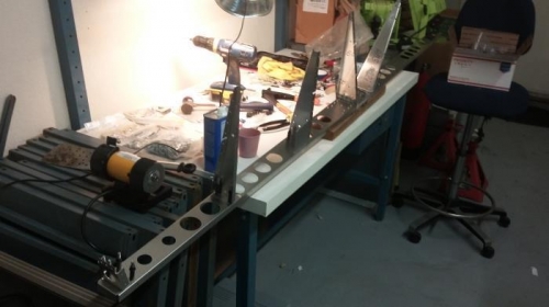

Thats me Riveting
