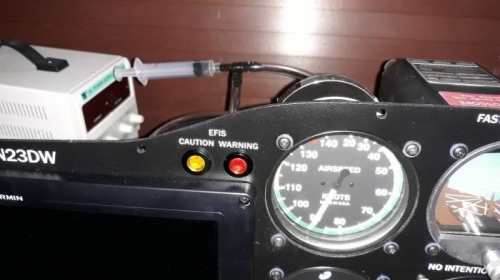

Brief Description:  2 Leak tested static and pitot lines
I used a syringe to pressurize the pitot lines holding the airspeed indicator at 90 kts for 1 minute with no movement.

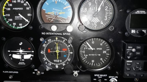

I then pulled a vacuum on the static lines with the syringe and watched the VSI jump to about 1500 ft/ and then settle down after the plunger was stil
The vacuum held the altimeter at 1080 ft and the airspeed to 70kts for a minute with no movement and then settle down after the plunger was still.
I then vented the static lines using the alternate source switch, and everything went back normal with altimeter returning to 820 ft (my home altitude.)
pitot line pressurized
static line vacuum
static line vacuum
alternate static source vented
