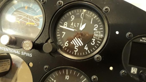

I have one Nulite illuminator for the altimeter, so I installed it to see how it looks. It sets the instrument back about 3/16" so I only bought one to see how it looks. Not too bad, so I ordered three more for the VSI, Airspeed and Turn coordinator.

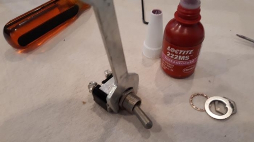

I set the standoff depth of all of my toggle switches to 1/8" using a wrench for a spacer and loctite for the nut.

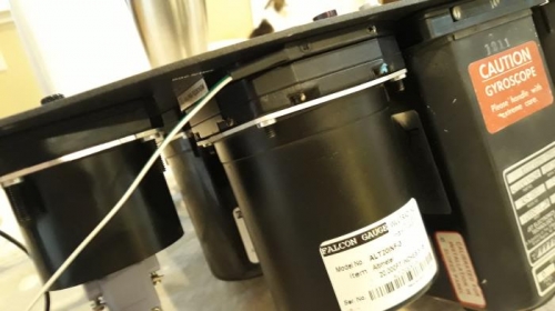

Nulite illumination for altimeter
altimeter set back about 3/16
altimeter set back about 3/16"
setting toggle switch standoff
