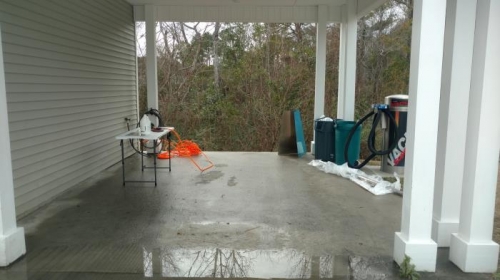

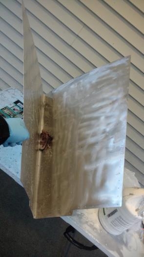

I decided to start over, and here I am again. Scrubbing new parts and getting them ready to prime at the free carwash of my apartment complex. I scrubbed the parts with a soapy industrial solution called "PreKote", and srcrub the metal with an aluminum oxide pad between 180-400 grit to remove any AlClad and aluminum oxide on the surface. The PreKote helps tremendously with this, and also provides a layer that assists in primer adhesion. This residual layer temporarily protects the surface, and allows me to spray primer within 24 hours of scrubbing.
The process is simple enough: Apply PreKote, scrub all surfaces working into a rich lather, and don't let anything dry. Add more PreKote
Carwash Carport
Carwash Carport
Scrubbed out skin of VS. I have one more scrub pass to make on this.

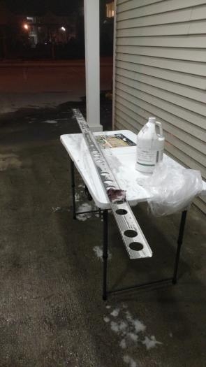

Horizontal Spar. Yes, the sun set while out here. It was a lot of manual labor.
