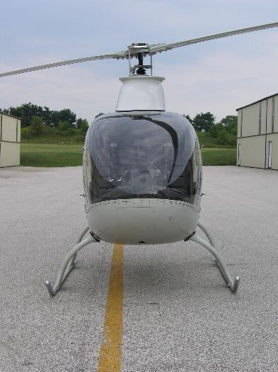

Redid hang test and W&B
Re-measured datum points and redid W&B. Also redid hang test with new hanging mechanism that lessened any friction issues. Also used a 25 lb counterweight and weights for the pilot for hang test. All angles were now within specification.
Front view
