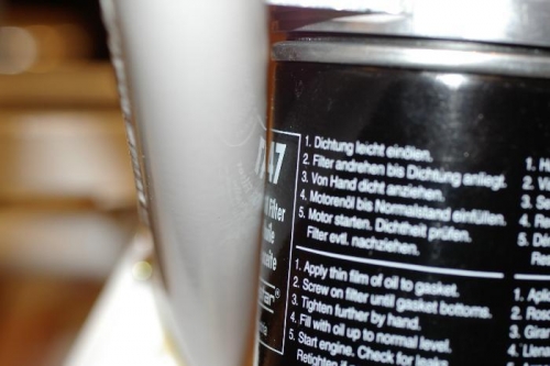

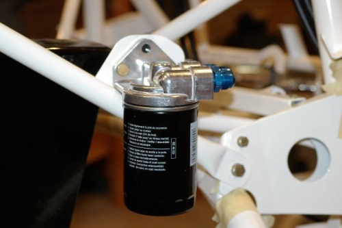

Mounted Oil Filter Weldment
During trial fittng of the weldment it was discovered that the oil filter itself rubbed on the airframe tubing. An aluminum spacer was fabricated to provide addtional clearance.
Filter rubbing airframe
