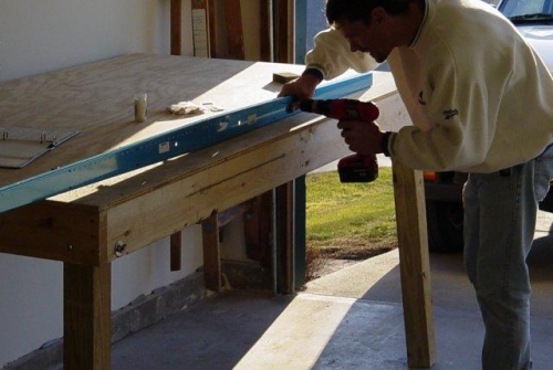

Smoothed the surfaces of the rear spar (HS-609PP). Also, using a #30 bit, I drilled out the undersized pre-punched holes used to attach HS-603PP to HS-609PP.
