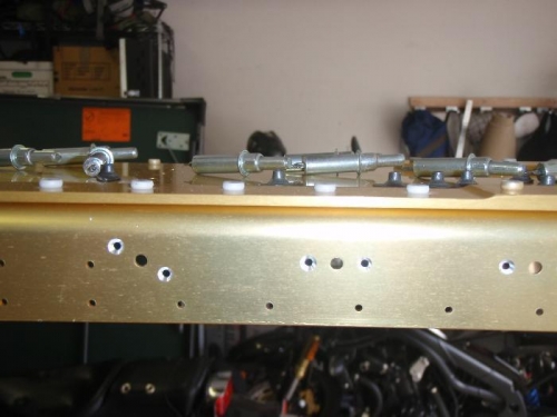

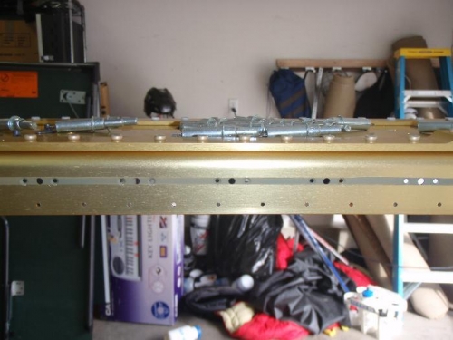

Began work on the spar
Riveted the tank platenuts to the wing spar. Took great pains to make sure when I countersinked the spar I didn't ruin anything.
That was a big step doing that first countersink. Countersinked the spar flange for flush heads of the AN 426 rivets on the outside of the flange.
Riveted all the platenuts after spot priming with rattle can primer the countersunk holes.
Also the rivet holes DID have to be drilled to #40 first.
