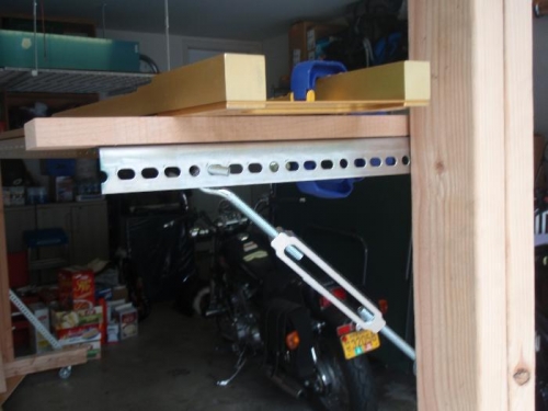

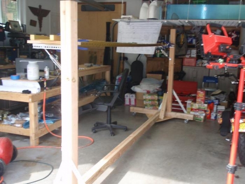

Brief Description:  Construction of wing jig
OK no way was I going to attach beams to my cieling joists as van's recommends due to space so after perusing lots of builders ideas on Doug Reeve's site I choose to modify a great jig by "Smitty".
I constructed the jig out of 2x4's, Steel angle, Steel bands and my main modification from Smitty's plans was using turnbuckles to make easy adjustment of level of the wing spar.
I used free castering steel wheels for mobility.
The jig works awesome.
The steel castering wheels are awesome for movement and the length of 133 inches between uprights work
Turnbuckles make for easy adjustment
