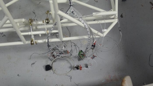

Finished up the Instrument Pod connections and I think all of the connections for the main harness. I decided to use lacing instead of zip ties to hold eveything together. I think it looks better, does not cut into the wires and will last longer. The EAA has a good video that shows how to do the lacing.

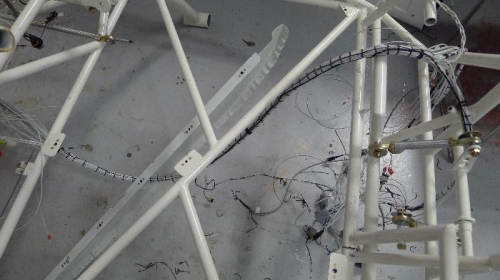

The second picture shows the bundles that go into the instrument pod. They are also laced together by function.

Main Harness
Main Harness
Instrument Pod Harness
