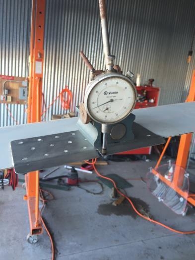

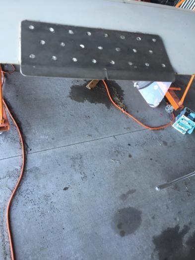

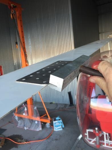

I have a supply of tabs as does Safari if anybody wants a set. It takes a special and expensive glue to put them on. It also takes a special tool and dial indicator (IMAGE 2,3) to adjust them. Using the tools I can adjust them by about 0.010" on a consistent basis. Adjusting with out the tools will do more harm than good.
Mounted Trim Tab
Mounted Trim Tab
Bending Tool In Action
Measuring the Change
