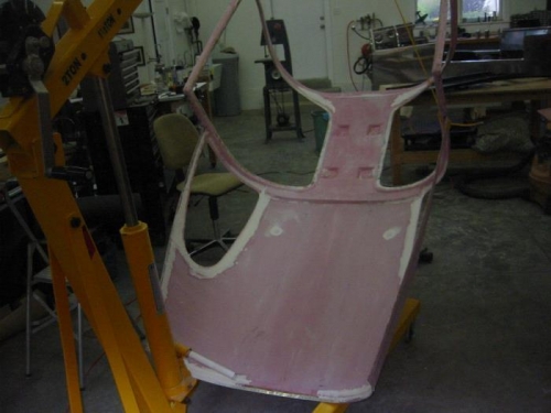

Sanded the complete interior of the the cabin top. There are several areas where the top has steps from starting/stopping the foam filler, like around the windows and at the edges. These would show up badly if painted with normal paint, but also would show with Zolatone. So I filled them with some filler. If you mix it with enough microballoons, it is very light, just hard to work with.
Removed the vents from the overhead console and sanded the joining surfaces and all the exterior that will get paint. Hopefully will glue it in tomorrow
