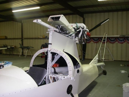

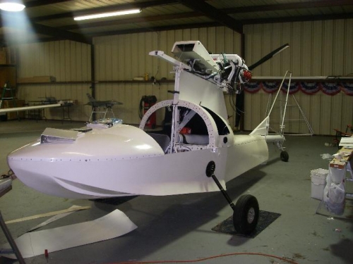

Approx two hours was spent fitting the pylon side-cover. I created a paper template by taping lots and lots of pieces of paper into position and then comparing it to the lines PA drew on the sheet aluminum. I took the more conservative of the two lines and cut it out using the tin snips. After lots of trial and error I got the thing put into place. The project was not nearly as bad as I anticipated. I'm still trying to figure out exactly how I will hold it in place. I'm still leaning towards screwing one side and pop riveting the other. Norm suggested just pop riveting the whole darn thing since they drill out so easily. We'll see.
