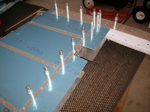

Brief Description:  Drilling the Elevator Counter Weight
Drilled out the 2 holes for attachment on the lead counterweight. Used #12 bit. Loaded up very rapidly. As per the instruction, I used a lubricant (3-n-1 oil) and worked much better. I don't have a drill press so I was worried about getting thru straight. Not perfect, but hopefully close enough. I may see if I can get my hands on one when I do my Left Elevator.
Dimpled counterweight skin at those two holes.
Primed the 703 and 704 ribs and then riveted them together.
