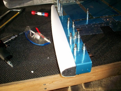

Brief Description:  Bending Trailing Edge
