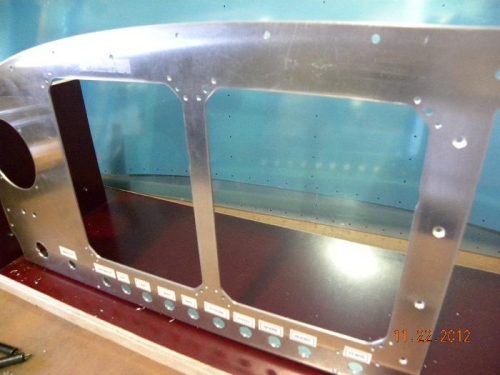

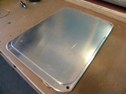

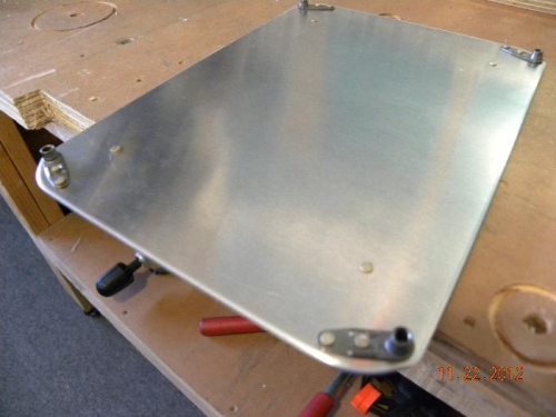

I disassembled and stored all the components from my panel in preperation of fitting the panel to the fuselage. I also drilled holes for the plate nuts at the G3x openings to support the G3X's. Additionally i completed fabrication of my "plug" for one of the g3x openings by riveting it together and installing plate nuts to hold it in place via the g3x mounting holes. This will give me an option to blank off one of the G3X holes. I will likely be adding the second G3X further down the road after phase 1 testing.
G3X blank off plug
G3X blank off plug
Panel disassembled for fuse construction
