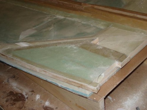

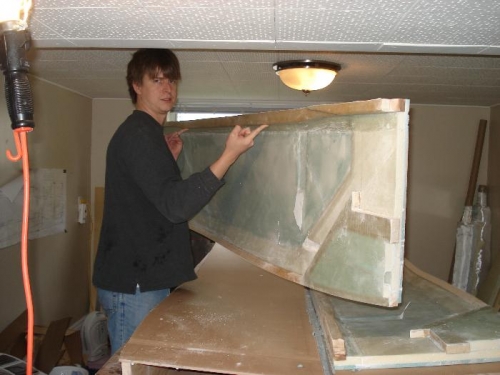

Brief Description:  Trimmed the ends and removed from the jigs
Trimmed the sides and removed them from the jigs. I actually trimmed them to 102" instead of the 101.75" specified in the plans. The plans call for tirmming the front endge straight and then trimming the aft edge at 101.75". Unfortunately this will cut into the main spar cutout area and make it too small. The spar area should have 5.5" of space. I believe the plans should call for one to first trim the aft edge correctly and then cut the forward edge at 101.75". When in doubt don't cut. I will do further research and consideration before I proceed. Having an extra 1/4" of length in the fuselage might not matter much anyway.
