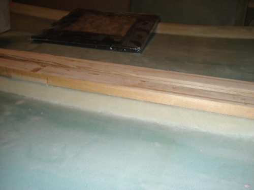

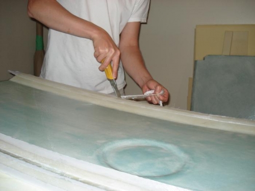

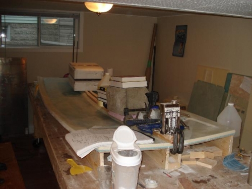

Brief Description:  Fuselage sides adding the upper longerons
Including the trimming and sanding this actually took much longer than I expected. I first had to sand the longerones to get the excess epoxy off. I actually wieghed them just for fun before and after the sanding. The carefull sanding actually saved 50 grams each. If I were to do this again I would setup the jigs with more space between to get clamps into the center instead of weighing the whole thing down. In the end things fit together well.
