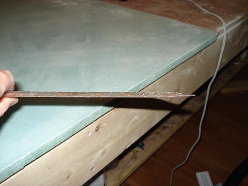

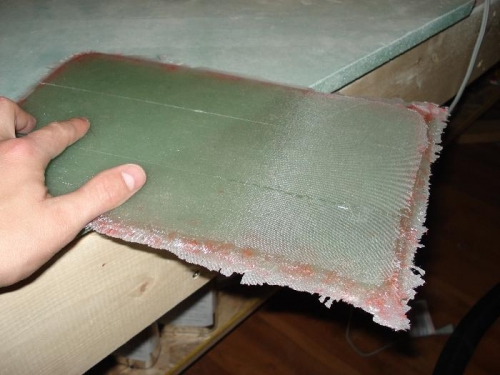

Brief Description:  Hardpoints for landing gear bulkheads.
Looked ahead in the plans and made the glass layup for the landing gear bulkhead hardpoints. It is basically a simple layup of 22 layers of bi-directional fiberglass. The finished sheet should be 1/4" which it is. It will later be cut into 4 pieces and embedded into the landing gear bulkheads.
