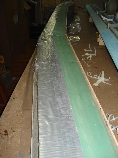

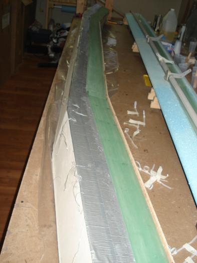

Did the top spar cap layup. Percut all the tapes according to the schedule in the plans, built a plywood dam against the shearweb, and then spent about 8 hours on the layup.
