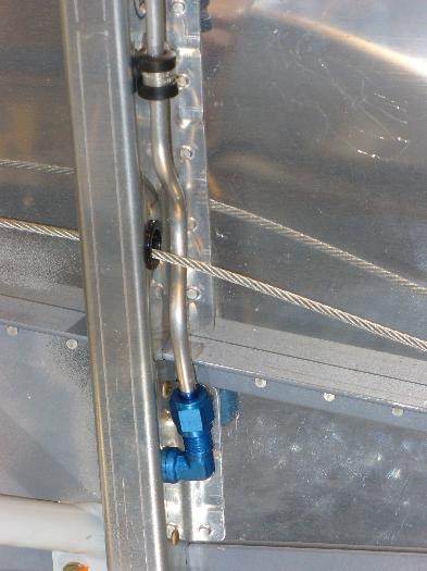

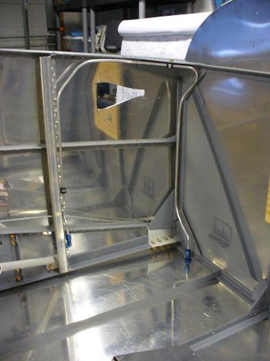

Brief Description:  Left fuel vent line fabrication
Made the left fuel vent line with 1/4" alum tubing. This tube connects to the fuel tank and provides a rise to prevent fuel from leaking out. The front end runs out the bottom front of the fuselage - a fitting hear allows ram air to blow in and charge the fuel tank a little (maybe 1 PSI). It was easy to bend by hand, though a couple curves were done with the tube bender. Overall, it took quite abit of trial and error until the tube followed the path I wanted.
Vent line bent to fit
Detail where it goes through bulkhead
