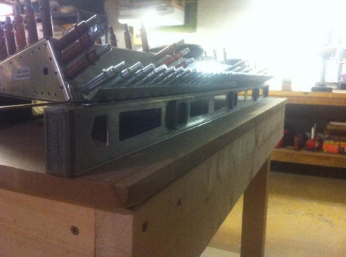

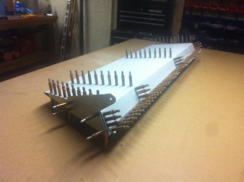

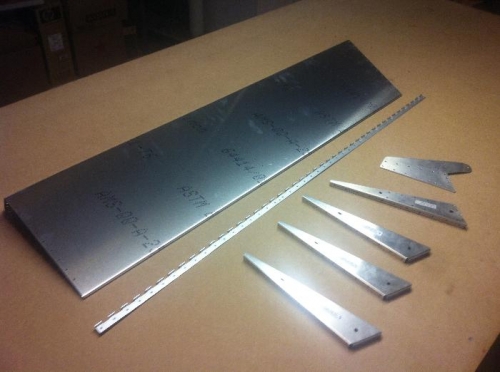

Brief Description:  RH Ruddervator Hinge Final Drill
Positioned pilot-drilled hinge to ruddervator skin per drawing WIX-T05. Hinge set ~0.057" below skin surface as specified. Aligned hinge to aluminium level to ensure hinge was straight and set gap with a small piece of scrap metal. Removed all cleco's to prepare for deburring.
Used level to ensure hinge was straight
RH ruddervator drilling complete
Ready for deburring
Ready for deburring
