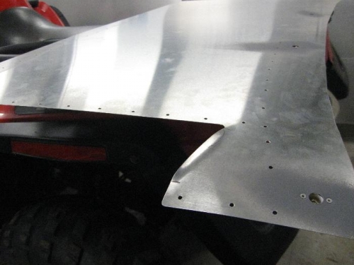

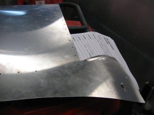

Trimmed the perimeter of the bonnet with my OLFA knife, filed and deburred the edges and holes.
Flared the cheeks to clear the canopy side flashings.

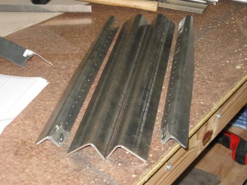

Bent new spar uprights as the supplied ones were wide enough accross the front of the spar.
New angles in the middle that I bent up with a press bender that I made
