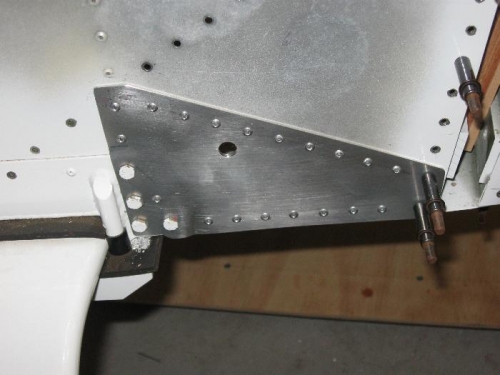

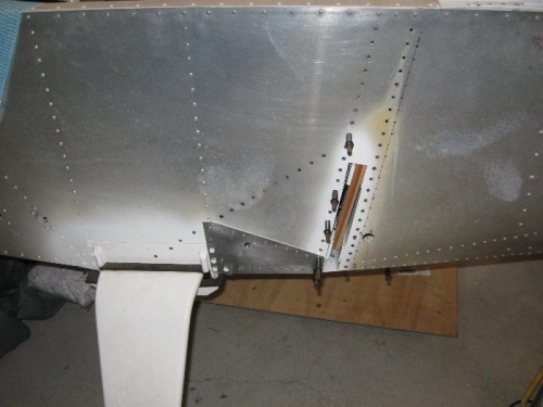

Fitted the fuselarge side doubler to the outside of the fuse by making a joggle in the doubler to allow it to sit over the gear plate.

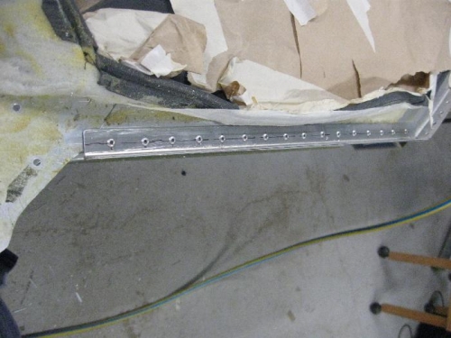

Added the .040" angles to the arm rest where it meets the seat bases.
Notice the joggles above and in front of where the gear plate sits under the doubler
A crap photo.On the left is the front and far right is the angle that rivets to the gear channel
