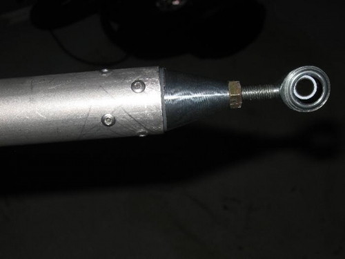

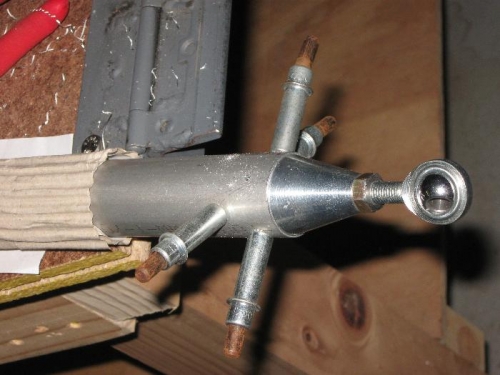

aileron pushrods

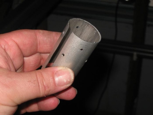

Made a jig for drilling 8 evenly spaced and staggered rivets around the tube ends.
Drilled and installed the tube ends to one end of each rod.
8 x avex A5 rivets evenly spaced around the tube
Used the jig to pilot drill the tube before the tube ends were inserted.
Jig is made from an offcut of tube and opened up so that it slips over the original size
