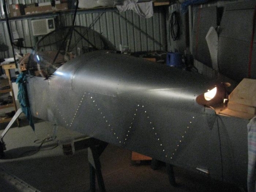

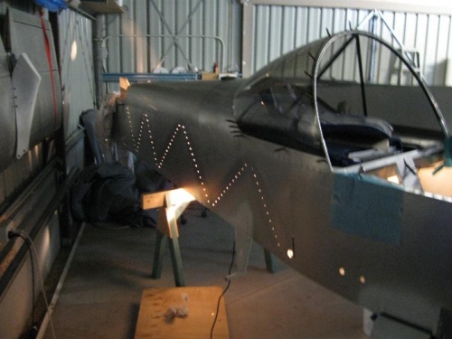

rear fuse stiffener angles
Pilot drilled the rear fuse sides diagonal bracing holes to match the Ch650. Rivet pitch is 40mm A4
Couldn't find the drawing on the net for the rivet pitch.
Looked at many pics, the pitch looked the same as other rivets lines on the fuse sides which are 40mm
