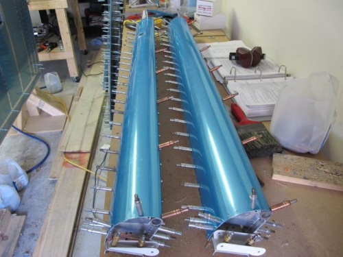

I drilled the aileron leading edge skins to the galvanized counterbalance pipe with an old bit and promptly threw it (the used bit!) into the trash upon completion. I used a 12" #30 to drill the inner tabs on the leading edge ribs to the pipe. It fit through a #30 hole in the spar reinforcement plate and then I was able to drill the tab.

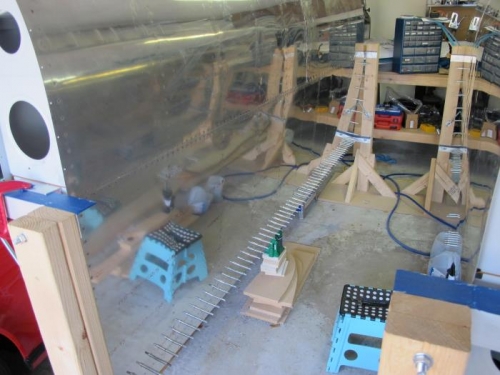

Ginger was kind enough to come out to the garage and shoot the left wing top skin rivets.She did a great job. If I didn't enjoy building so much, I would let her build the entire plane-she's a perfectionist. The wings are now ready to come off of the stands and go into the (as yet unconstructed) wing cradles. It's time for some woodworking.
Drilled Aileron Counterbalance to Skin
Left Wing Top Skins Riveted
