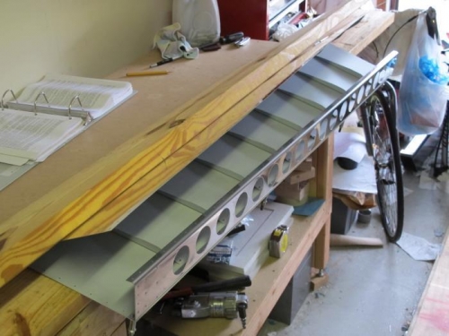

I got the left aileron skin and braces primed before the rain arrived. I back-riveted the braces into place and everything looks good.

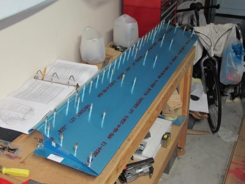

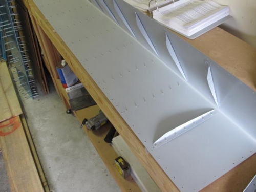

I moved on to flaps and constructed the spar doubler supports from the supplied sheet. I matched drilled them and then drilled out the holes for the AN3-4A bolts to #12. I clecoed everything together and match-drilled the skins to the spars and ribs. I seem to be missing one K1000-3 platenut for the doubler plates.

Left Aileron Primed and Rivets Taped in Place
Using Bending Brake on Trailing Edge
Right Flap Caught up with Left Flap
