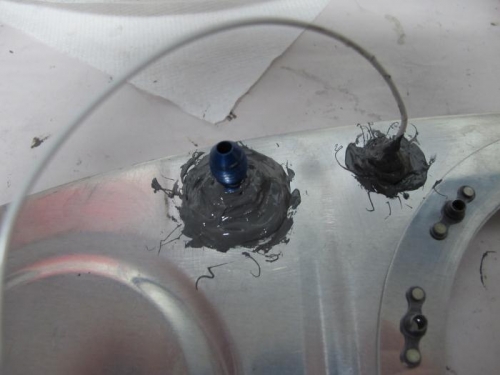

I installed the crimped wires to the outboard capacitance plates and angled the connections so that they would not interfere with the vent tube when installed. I prosealed the wires to the plates forming fillets around the wires, crimps and nuts. I installed the vent tube fittings and BNC connectors in the inboard ribs and prosealed them. I touched up the fillets in the left tank with the remaining proseal.
Sealed BNC and Vent Fitting
