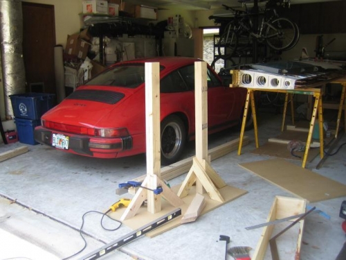

Brief Description:  Rear Spar, Wing Stands, Leading Edge Cradle

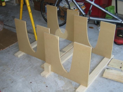

I began building my wing stands in the style of Ethan Jacoby and Andrew (n999za.com). I constructed my leading edge cradles out of MDF and wish I had used plywood instead as the MDF is relatively fragile when it comes to moving the cradles around. Braces help, but plywood would have "stood on its own." Lesson learned and the wing cradle will be made of plywood (already purchased for the occasion).
Wing Stands Under Construction
Leading Edge Cradles
