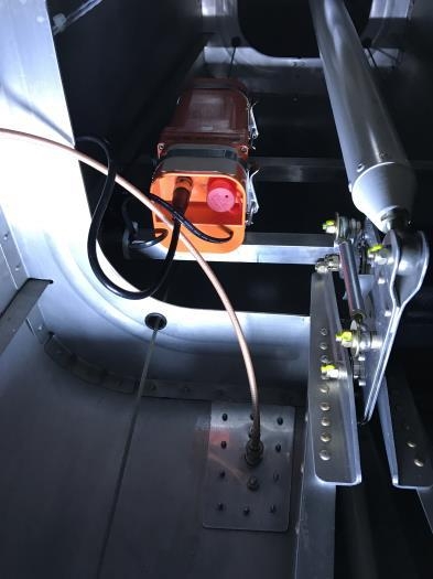

• Found the red ACK Technologies ELT Cap and installed on the ELT, this cap holds the arm switch in the armed position.

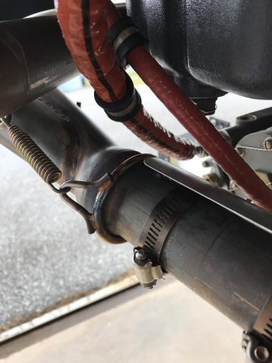

• Loosened the fuel line connector at the fuel servo, moved up, which moved the fuel line further away from the exhaust, re-tightened. Secured the fuel pump to servo line via cushion clamp to the servo to divider line via another cushion clamp.

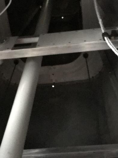

• Drilled #40, then 1/8" holes in the fuse just forward of each bulkhead to allow for water to drain out of the fuse.
Found ELT Cap and Installed
Secure Fuel Pump to Servo Line
Drilled 1/8
Drilled 1/8" Fuse Holes for Drainage
