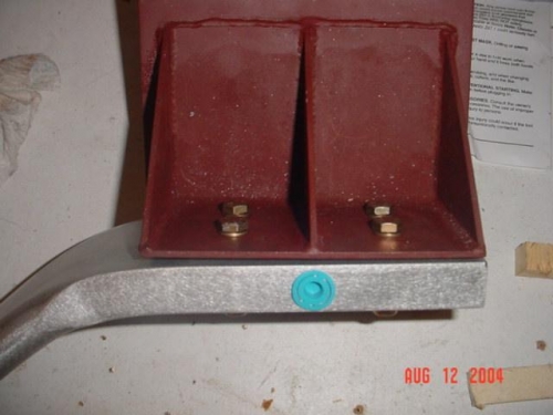

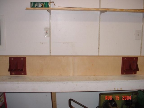

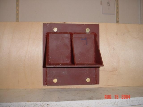

Brief Description:  Main Landing Gear Bracket Installation on Wing Spa
The holes drilled in the wing spar were reamed to the exact dimension required for the bolt. Thin epoxy was applied to inside of hole with a pipe cleaner. Bolt pattern was good and brackets fit on both sides.
Main Landing Gear Bracket on Wing Spar

Port & Stbd Landing Gear Brackets on Wing Spars
