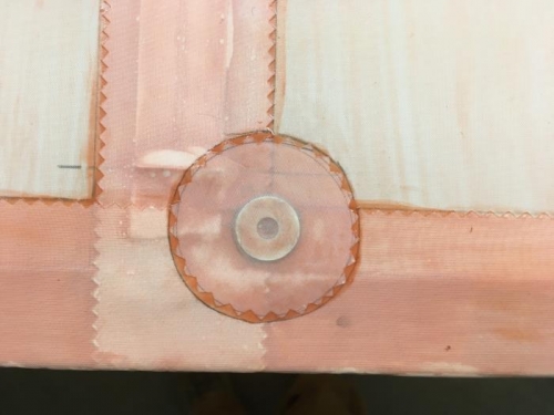

Installing drain grommets in wings
Additional drain grommet pictures

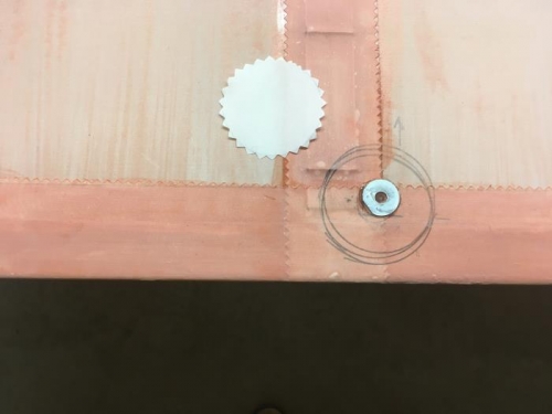

Step 1: locate location for drain grommet and mark

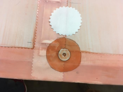

step 2: Poly task grommet to wing, then add polybrush base layer
Step 3: Cover grommet with reinforcing tape and add more polybrush
