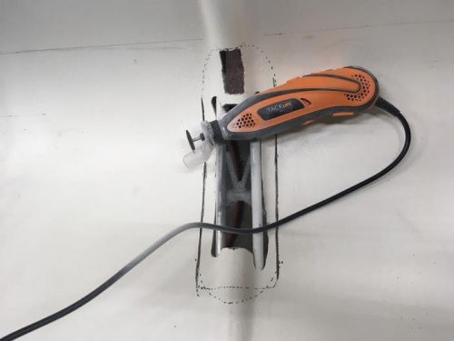

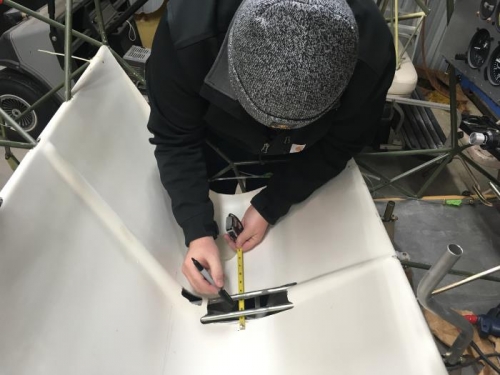

Derek has been working for the last couple of weeks on making adjustments to the Kitfox's seat pan. There is a very narrow channel between the seats that is supposed to provide clearance for the flight control system that foes underneath the seat. The controls rub significantly. The plans call for us to bend the control rods until they clear. We are unhappy with that solution! We are cutting out the middle of the seat, and then will re-glass it with a wider and deeper well.
Derek works on adjusting seat pan to fit controls
"Dremel" tool used to cut seat pan.
