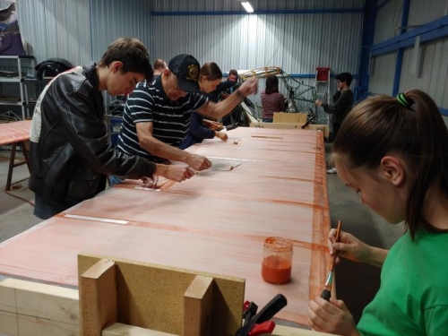

More work on the wings! The majority of the rib lacing on the left wing was completed along with more base coats of polybrush in preparation for the reinforcing tapes.

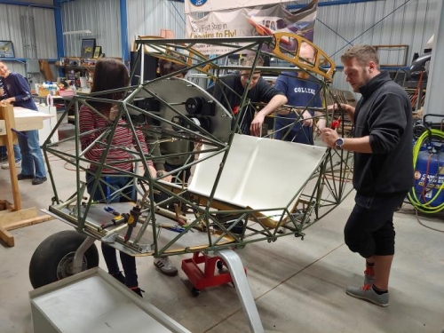

Additionally, we are reattacking the installation of the fiberglass seat pan. The seat currently impinges on the controls (that travel in a narrow channel in the middle of the seat) and are also concerned about how the seat connects to the frame.
10 folks tonight working on the wings and seat pan
great minds evaluating how to best install the seat
