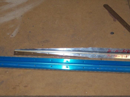

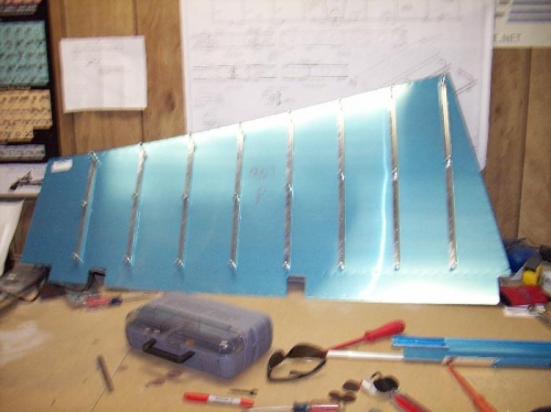

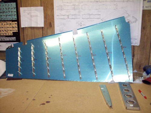

Brief Description:  Rudder stiffeners
Fabricated the 915 rudder stiffeners A through G for both left and right rudder skins from prepunched angle stock. This is quite tricky - I don't know how you would get it done without a dremel tools and a scotchbrite wheel. Clecoed and match-drilled both skins to their respective stiffeners.
