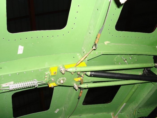

Image one is where the flap control horn meets the wing flap support fixture. We need to drill out the flap tube on the inside fuselage to 5/8" so we can insert a socket to hold the nut that's inside. Otherwise have to disassemble the flap control assembly inside the cabin to remove the flaps for maintenance.

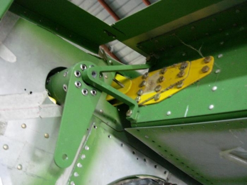

Image two shows the important flap droop aileron mixer assembly. It's going to be fun rigging that. In my opinion, we may want to block out the droop system. It may be an unnecessary complication for very little improvement in lift. Flight test will give us the final answer.

We finally decided to leave the aileron droop in. It does not seem to affect the total aileron displacement in a negative way. Luckily the decision can be made later in flight test, because blocking the droop is a relatively simple process.
