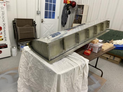

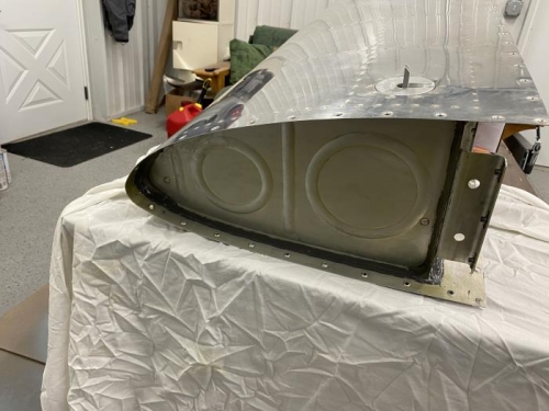

Brief Description:  Fixed fuel tank leak.
Fixed the fuel tank leak on the left. It was at the extreme outboard end at the bottom of the tank. It was just a seep through a small pinhole. I was able to get some sealant on the inside through the filler hole and then some on the outside as well. Tested the repair after curing overnight and looks good.
