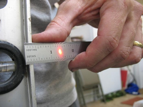

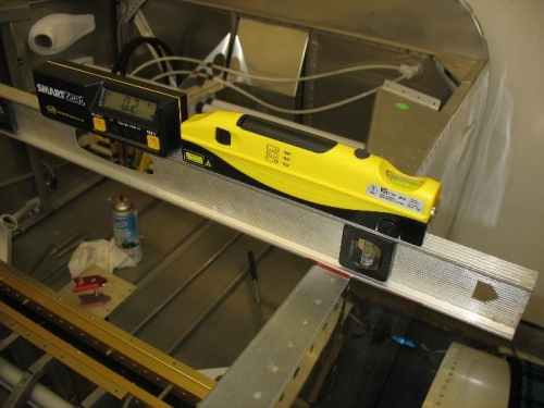

Brief Description:  Aligned right wing with fuselage
Instead of using the plumb bob method desribed in the plans for measuring wing sweep, I used a laser level aligned along the main spar. Several iterations of rear spar shortening were necessary to get the forward sweep down to under 0.25"
