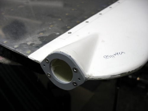

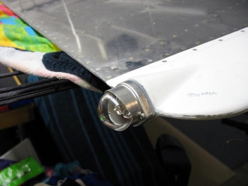

Brief Description:  Fabricated rudder nav/strobe mount
Based upon another good VansAirForce forum idea; I made a mounting plate for the Whelen A500 white position light/strobe assembly. The plate blind rivets to the flanges of the rudder bottom composite fairing and then the light's (2) 4-40 mounting screws threads on to it.
