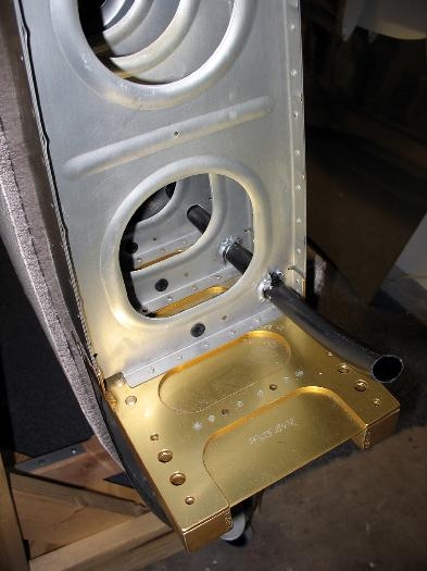

Brief Description:  Ran wiring conduit in both wings
After being disappointed with Van's corrugated conduit, I switched to 0.7" OD polyethylene irrigation pipe. This installed much faster and I'm sure its smooth bore will permit easier wire pulling. Tie-wrapped in three places and then RTV'd at every rib.
