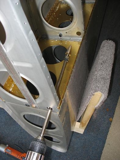

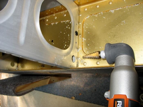

Brief Description:  Drilled wiring conduit passage thru both wings
Ended up choosing Van's corrugated tubing. Located the holes in all the ribs using a simple template. The actual drilling went quickly enough given a r/a drill, (3) 12" extensions and a 3/4" unibit. Cleaned up the burrs with a die grinder, emory cloth and a needle file.
