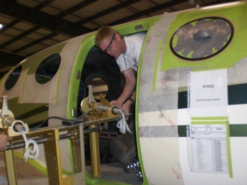

Carry yoke into plane

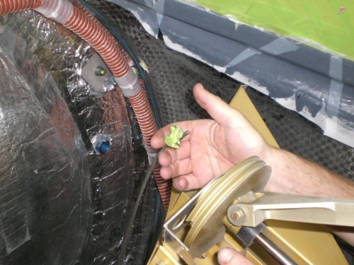

lay on back, insert aileron cables through pulleys. attech to sectors. safety wire screw to sector. re-install cable guard onto pulleys.

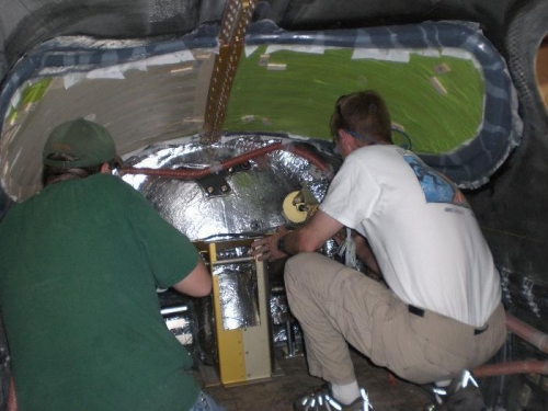

clear insulation from mounting plate on firewall.
push yoke flush with plates on both sides.
top two bolts on each side enter from inside.
bottom bolts outside in, countersunk flush. torque 40 ft lbs (all six)
attach outer legs to cross brace on floor, torque 40 ft lbs
attach elevator cables to elevator, reinstall cable guard.

insert cable through pulley
