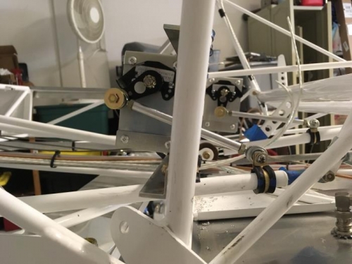

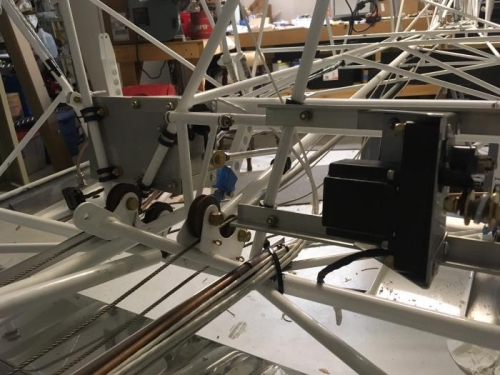

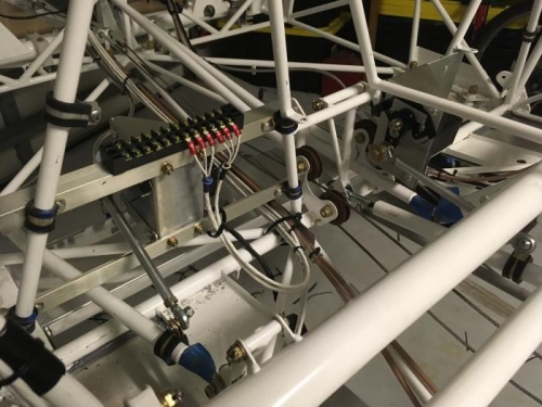

Assembled and installed the flaperon servo. Ran the wire from the instrument panel to a terminal strip behind the seats for the landing and nav lights. I decided on this method since I don't like molex connectors and I wanted a way to easily remove the wings if neccessary.
Terminals for wing wiring
Both AP servos from the side
Flaperon servo on the right, elevator on the left
