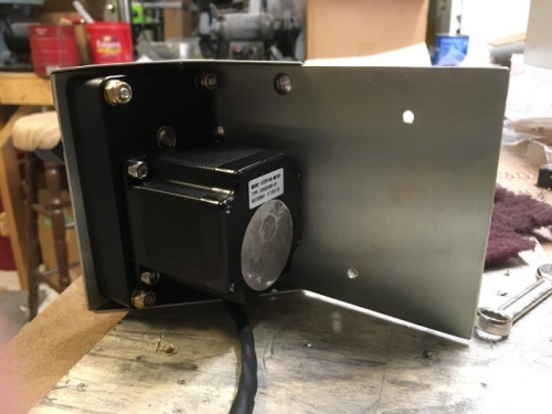

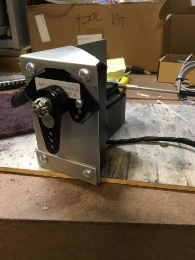

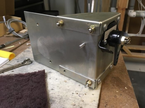

Continued making the servo mounts then alodined all the parts. I put the servo for the elevator in place. I think I was able to get enough travel before the servo arm hits the safety stop by slightly grinding where the arm makes contct with the stops. I also checked how much additional travel they have and it is at 120 degrees which is exceptable per the Dynon directions.
